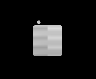

Do you still experience the same issue after slicing gets completed?
the layer half shade was a mask issue as you mentioned, i tested the ascii & bin, but still lacking the mesh area information ![]()
The "halfshade" was mask issue, strange why its was activated, maybe accidently...i solved spherical distortions physically lens set, it was not required feature before, but some way i resolve to check anyway... thankyou
But the main issue still happening, the missing layering information inisde (Toggle Details) which we use to plan the strategy on formula box.
I export tha same stl both in ascii and bin versions, the same result.other files was test with slc too same results....
It could be a mask issue. Remove it see if rendering become normal
mask is turned-off
may i send wetransfer link?
yes
all parts ( even with AA turned off) (bright-255) are reurning in half shade slices... its being an issue for me, and sensitive enough to 25µ pixel size, making dynamic cure not that eficiently
i have tried(stl binary,slc) upload again, with no success.
it seems that formula is being calculated, but theres no info from layers section
even if i disable the AA, the output image is retuning an halfshade on every parts with quads area
