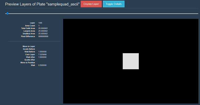

On nanodlp setup, enter correct native resolution(lightcrafter) which is 912x1140 to work with pattern mode to get real pixel relay without any processing.
and from raspberry side i modify the config.txt to output this native resolution with custom mode dvi group:
pi@raspberrypi:~ $ tvservice -s
state 0x120006 [DVI DMT (87) RGB full 16:10], 912x1140 @ 60.00Hz, progressive
everything matched, when you open preview on nanodlp you could see the aspect ratio is correct on layer preview page, even on projector gui control software.
but the output is out incorrect sized.
anyone would make a guess?
