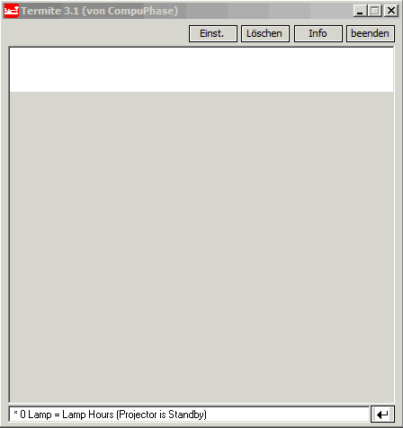

I have made some test inputs.
It seems that the answer *000 is " OK " and *001 is " NOT OK " means .
The return value 0389 are then the lamp hours
The projector must be turned on, not standby, then i get this response:
Is it possible to show the Lamp Hours on dashboard, if successful queried ?
Here the terminal output:
Unfortunately "Query Lamp Hours" with my projector does not work ( acerH6510BD ).

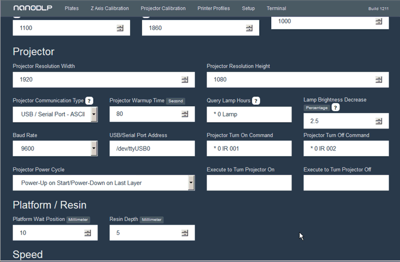

my projector is a Acer H6510BD and for the Serial Command i write into "Setup" - > "Query Lamp Hours" * 0 Lamp
and in "Lamp Brightness Decrease" 2.5
But I can see nowhere the Lamp Hours.
Even a change in the exposure times I could not notice. It seems as if nothing happens.
Should not be anywhere displayed the Lamp Hours?
