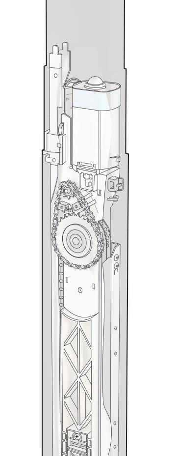

  11. CutAboveZ
    CutAboveZ Well-Known Builder
    Maybe look around for a sit-stand desk mechanism, the rage of all offices these days. There has to be used ones at office surplus stores.
