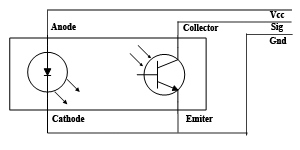

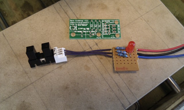

    So I salvaged these photo interruptor sensors from an HP Laserjet 5000 printer.
    I think I figured out how to use them. This is what's going on inside them.

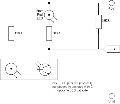

    Here's a schematic of the parts:
    To use a photo interrupter you will need to identify the three wires leaving the photo interrupter. They are Vcc, Gnd and signal. Vcc is connected to the IR LED anode (+) , signal is connected to the photo transistor collector (+) and ground is connected to both the IR LED cathode and the photo transistor emitter.
    And here is a sample circuit:
    I believe the arrow pointing to the right is the "detector" which you connect to your machine limit switch inputs. All of this was provided by https://capolight.wordpress.com/2010/11/24/making-endstops-from-printer-photo-interrupters/
