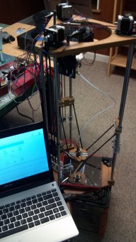

  2. nicklogan
    nicklogan Well-Known Builder
    See attached photos. Reply if you'd like to see more.

  3. Darkfibre
    Darkfibre Well-Known Builder
    Thanks for the pictures! I'll be watching this one.
    What do you mean by 'polyurethaned'? I assume it's to coat the MDF to keep moist out, but what kind of paint or resin are you using, and do you feel it's working well?

  6. nicklogan
    Polyurethane is a clear tough coating commonly used as a top coat on wooden floors. Every paint or hardware store carries it. I rubbed on 2 coats with a soft lint free cloth. It hardens the surface and hole interiors of the MDF quite a bit.
