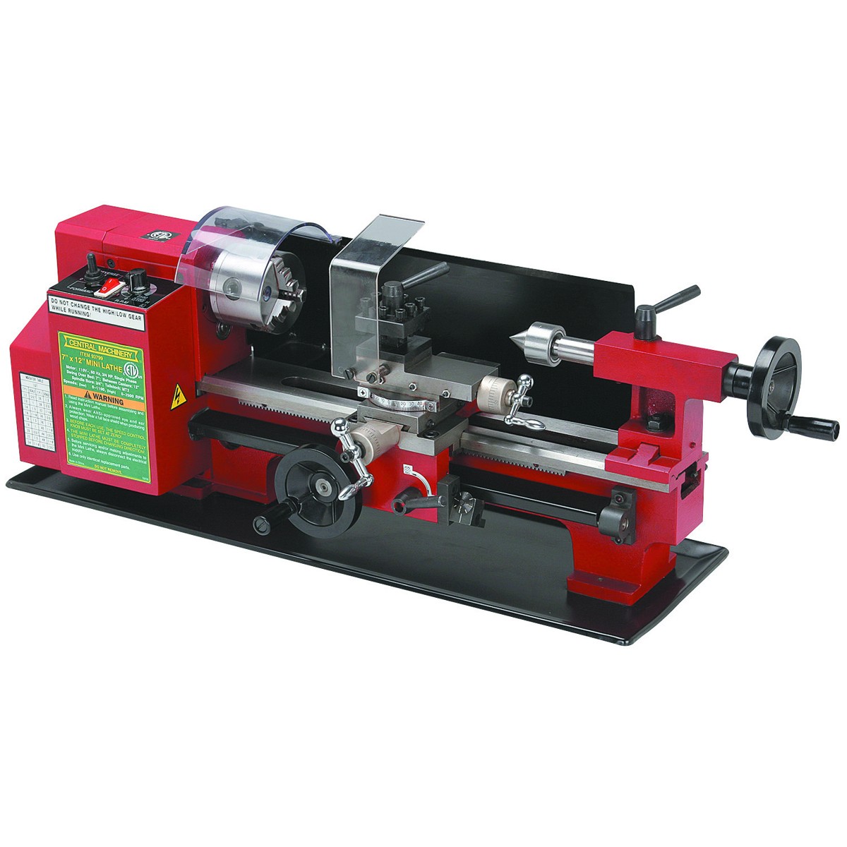

    OK justinat what is the base machine (MFG, Model and such) because it look alot like an older SIEG C3. I was just wondering what changes might have to be done to convert one of the standard mini lathes such as this.
    Maybe some small changes will make it useful.
    Bob
  3. Justinat
    Justinat New Builder
    Its a Clarke 12in bed. Basically the same as your pic there are a bunch of companies that brand these lathes. Mine was purchased a few years ago from tractor supply.
    I started off with a 1605 ball screw and mounts ( got them from automation technology but they are available from a bunch of sources ) for the carriage
    The cross slide was a little more challenging as a small ballscrew setup is pricey so I decided to go with acme lead screw single start 3/8 righthand( From McMaster ) and a Delran zero backlash Nut ( From Dumpster CNC ) - At this stage I'm still working out the bearing setup for the Leadscrew
    The electronics I went with a Gecko G540 and 381 oz stepper motors a index pulse board and Variable speed control ( From cnc4pc.com )
    my goal is to have a machine that's capable of making small parts and treading.
    the one down side I see with these machines is they were never intended to be more than a hobbyists machine and stock they have a very rough build quality. I had this one sitting around so I thought it would be a good learning experience.
