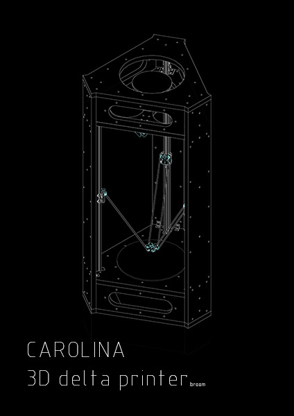

    I'm planning also a Delta, which is similar to your design approach. I'll upload my plans in the next two weeks. Maybe we can learn from each other. It will be out of 21mm plywood and it will be cut with a cnc in the next month. I wish you good luck with your build!
