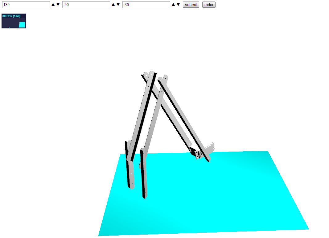

    check out this project i made... you need a OpenGL compatible browser ( notice, it works correctly if show some FPS counter on left side of screen and some arrows near the textbox's to change the XYZ values... then it submit.

    hi, and thanks.. well it should work in chrome.. i think the animation only work in chrome.. try to update it...
    its some robot arm, i make the code for arduino control 3 servos (180º) so the robot "hand" move as a CNC... with XYZ coordinates...
    im sorry for the bad english :p if anyone is interested i can share the code and the concept :p

    it work in my chrome, it must have WEBGL activated, it should look like this... [​IMG]
    and move after hit submit...
    last try, check this website: http://threejs.org/ if any of the samples work, my site should work too..
    thanks for the replys :)

    Ok it's working now (needed hardware acceleration turned on in Chrome settings) very cool the way it moves nice job!
