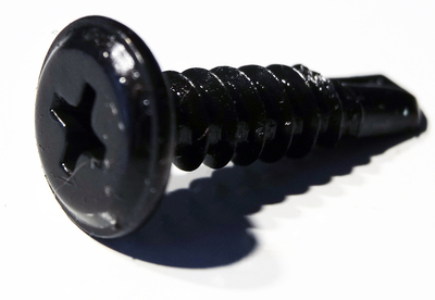

    Thanks for the tip @rpleyva to be honest I no longer tap the holes and have been using the self taping screws.
    Its a lot quicker and they hold very well. The V-Slot holes are still a little tight (working on that) so you have to run these screws back and forth a couple times but they are much quicker to use.
    http://openbuildspartstore.com/self-tapping-screw/
