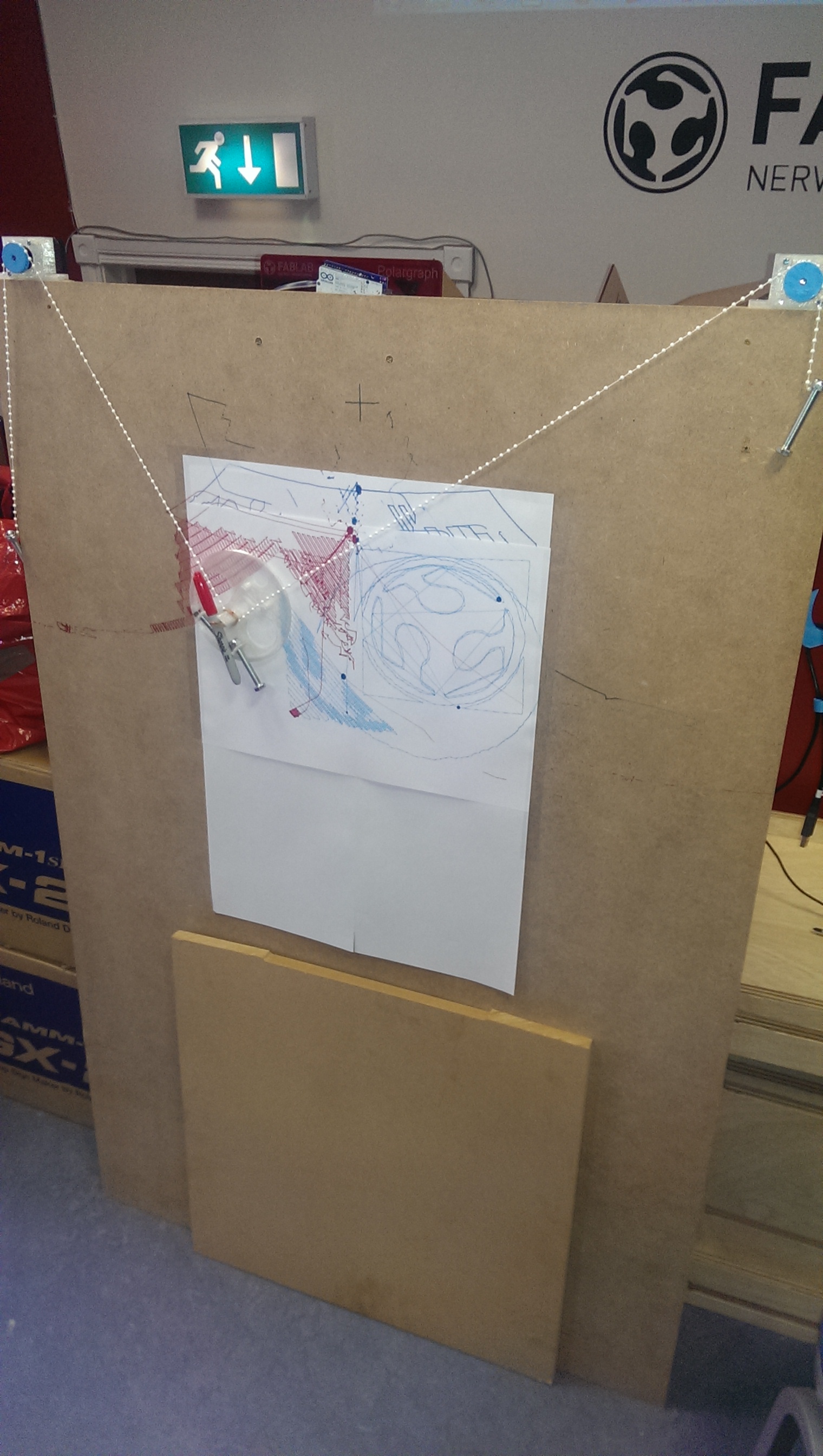

I've built a polargraph using:
Arduino Uno
Clone Motor shield (DK Electronics - this appears to be the same design as the Adafruit motor shield [V1])
2 x stepper motors (4V, 1A, 1.8 .deg step, bipolar)
and beaded cord nicked from my mam's blinds! (I need to get some longer ones to make use of the full machine size)
I have installed all the necessary bits (controller, arduino polargraph server, processing etc) but I have a problem.
The only complete drawings I've yet managed are trace captures.
Any of the pixel drawings I have tried stop within the first 1/8th or so of the drawing. It looks like they are loosing serial connection.
