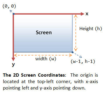

    it depend on how you have oriented the axis, because in computer graphics the coordinates are like this:

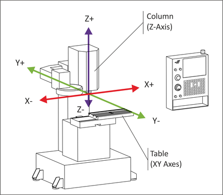

    but CNC machines have a different standard for axis directions, in the above drawing Y would point up and 0,0 is at bottom left of the cut area. It is known as the right hand rule and Gcode interpreters follow it. Note that the directions describe tool motion .

    It's the standard cartesian space
    I like this way (computer graphics way), because when the laser it's in X0 Y0 i have the working area free... (and less code complexity :p)
