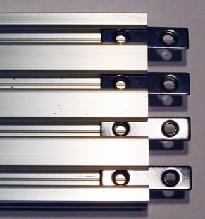

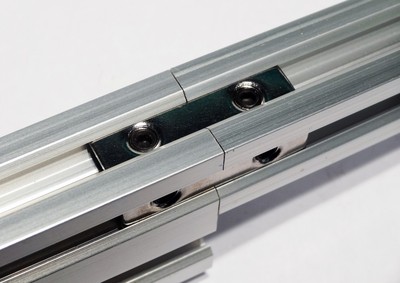

    Whats the longest 20x80 you could get as a special order? like 2, 2.5 meters? Because then you could build a very inexpensive 4ft x 8ft router for working sheet goods :D
  2. kram242
    Well the longest we make is 1.5m because from what we have found is that the longer the extrusion the more you run into the chance of mis-alignment and deflection issues over the span. We want to ensure we have nice straight accurate extrusions so we stay below 2m. You could however use plates to connect them or even maybe double tee-nuts in the slots for allow profile connection.
