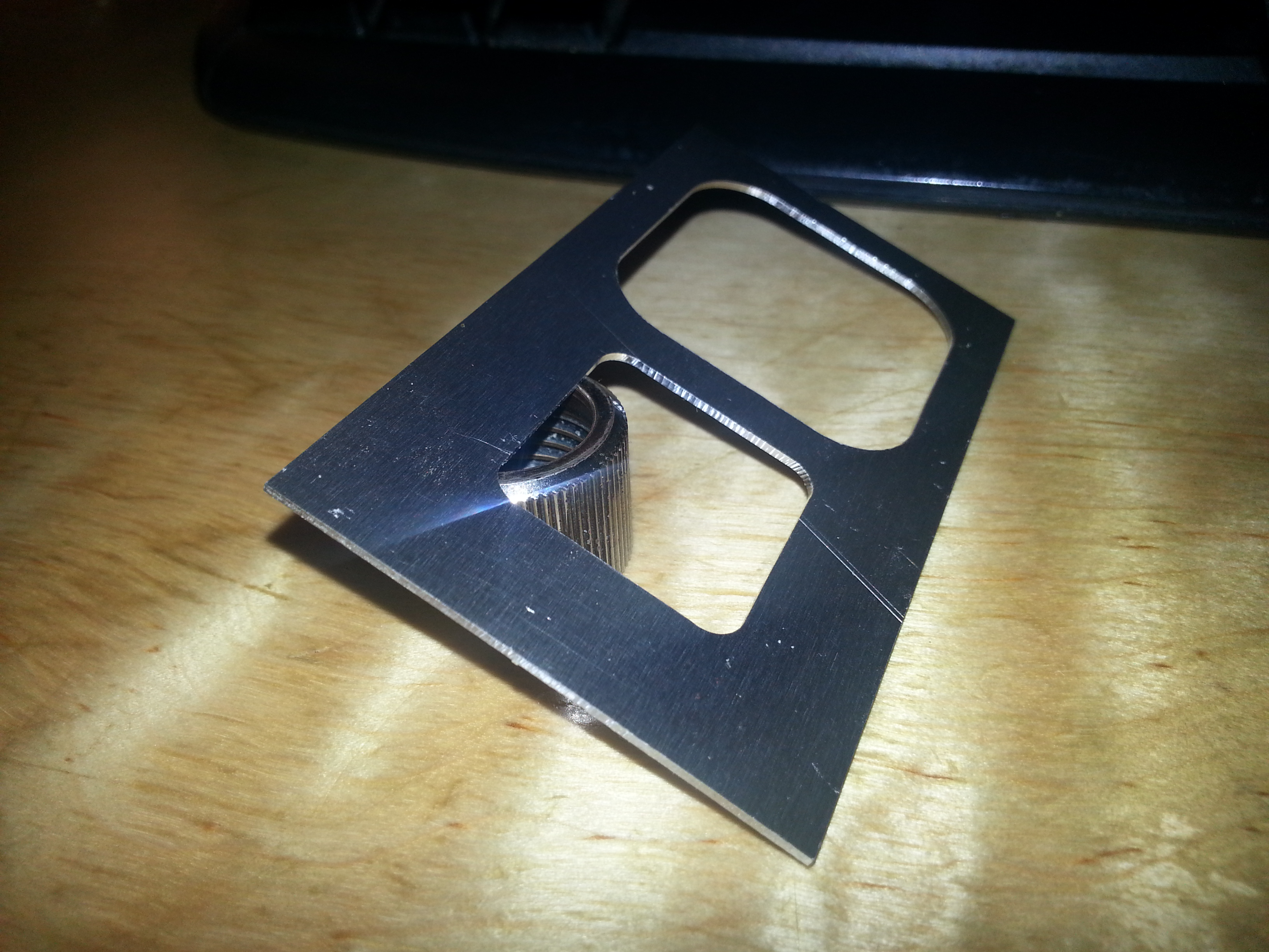

    Just spend 4 hours trying to find right combination to mill 1/8" think aluminum sheet to make some brackets. End result, think I will use Garlite! Never could get it to run consistently to cut with any sort of speed at all. Seemed to be an issue with motor power in Y and X directions. I will try a bigger power supply when I get it maybe this weekend, but problem mostly seems to be Dremel tool is not powerful enough, although maybe not, as I can push the aluminum sheet through the mill without too much force ... maybe the mill will just not cut well with the first mm or so of the bit? Or maybe this is a job for an OX? Perhaps back to Garlite milling for OX plates ... ;-)
  23. Forrest DIetrich
    Forrest DIetrich Journeyman Builder
    I tried milling Aluminum with 1/8" mill at thickness from 0.1 to 0.5 mm and speed from 10 mm to 200 mm, no joy! See previous post ... could be 24v power supply does not have enough juice for 3 X,Y motors under heavy lode ...its a Mean Well RS-150-24, with 150 watts output should be around 6.2 amps ... I may put a volt meter on it tomorrow and try again.

    What kind of issues were you running into? and were you using LUBE? I have been doing some Aluminum on my big joescnc2006, and a little WD40 sprayed at the cut area now and then did wonders!

  27. Nick Lancaster
    Nick Lancaster Journeyman Builder
    I think you need to go even shallower on your cuts. .1mm is .039 inches and I could not get good cuts at .040 inches. try at .05mm. I made my good cuts at 30ipm, .025 DOC. 24k RPM. with a 1/4in single flute carbide bit.

    .039" is nearly 1 mm ... I was talking in mm ... so I tried much less than this. I would be happy to get 1/64", 0.4 mm. You were really moving ... maybe I am trying to go too slow. I am limited to 1/8" bit and about 15k rpm, so surface of bit is moving about 20% the speed of yours, and 30 ipm would be about 760 mm/min. About 4x my fastest try. I will check voltages tomorrow and maybe try at faster rate, with 2 flute carbide bit.
    How powerful is your motor ... seems jonescnc206 is made for full size router ... as compared to my little Dremel. I may have to put off the aluminum unit I get my OX mods done.
  29. Nick Lancaster
    Yep bad math on my part. lol. Thought I had devided 1in by 254 which would be tenth mm, but I had not. lol. And yes the JoesCNC2006 is a big 350lb 24x48inch machine.
    Yes I am running a 2.25 hourse router. On your dremel what kind of bit? how many flutes? Max RPM on the dremel? I have seen people with shapokos cut aluminum with a dremel on 12v steppers.
