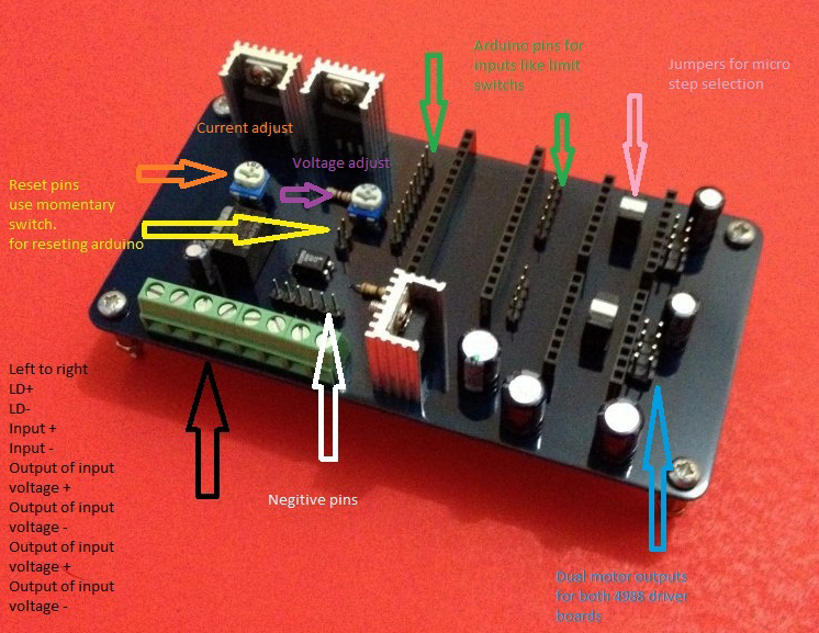

    could someone confirm that LD+ and LD- is for the laser diode, input thats where the power comes in (i know thats obvious) and the output of input could be used for the fans to remove the exhaust. is the reset pins for the arduino like a cancel button. and what is the negative pins for
  4. Robert Hummel
    LD+ , LD- are for the diode connection
    The reset is for the arduino
    The negative pins are for limit switches

    Can I ask a question about the 2x 330 uF caps on the board that you have placed between Vmot and Gnd. This is in addition to the 2 x 100 uF which are placed close to Vmot pin 11, and which appear in most stepstick circuits. I wondered if you needed to add the extra smoothing caps because you found problems with noise, or maybe they are there just as a precaution? Reason I ask is because I am playing around with a similar stepstick arrangement for the first time, and any operational feedback is valuable (except from the motors of course ;-) )
  30. Robert Hummel
    They are there as precaution and because the 5v reg is feeding from the same line as the stepsticks I wanted to be sure no problems would arise for the logic.
